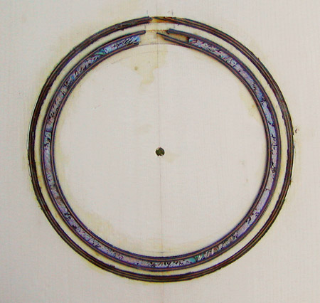

Sigh... I still don't like it. I think it would be great with a rosewood. I'm
going to rout the purflings back out and do a koa/pear/koa from Shane
to try bringing the browns out. I'm using mahogany and tortoise shell
bindings. I didn't realize Paua was so turqoise.
This will actually be good, as those will be slightly wider purflings. I
routed it spot on, dry fit it, then took it out to glue it. The glue made the
wood swell too much to fit in so I routed it out another hair. The hair
turned into a big gap I tried filling with some shavings from the
soundboard, and they stick out like a sore thumb.
PostPosted: Fri Oct 20, 2006 11:05 am
Is that flushed?
That doesn't look terrible to me. It just looks rough.
scrape it and sand it out... it might look fine.

It's not totally flushed yet. I like it, just not for what I'm after on this
guitar. I think it would look really nice with rosewood.

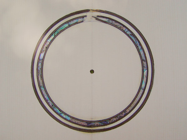

PostPosted: Fri Oct 20, 2006 3:36 pm
Posts: 785
James, I think you owe it to yourself to flush it and put a little shellac on it to see how it looks cleaned and finished. I agree it's rough now, but I quite like the combination and I think it will look very sharp when cleaned up.
Of course, if that discoloration in the left of the outer band is a filled gap, I agree you should fix that. A rosette draws the eye, and it has to be blemish-free. But personally, I would fix it with another black/koa combination, because I really like the look you have created here. If you find the black overwhelming, then you could double up the koa lines in the outer band, and that should mute the black considerably.
I hear you about the wood swelling. I have never been able to get that right with the method you describe. Nowadays, I always shellac the channel, wait till it's dry, install the rosette dry, and wick in CA to adhere it. I'm just not good enough to do it any other way.
Good luck; I'm anxious to see how it comes out!Kelby39011.0269907407
PostPosted: Fri Oct 20, 2006 4:51 pm
James,
I agree with what others have said. I like the effect you are getting and you do need to level it out. You will need to do that before your re-rout in any case. I will get the other purfs ready for you but you may actually like this look. Try cleaning it up and then put some shellac or naptha both on the rosette and on your mahongany and lay them beside each other and see how they will look under paint.
I do really like what you have come up with there! But the first person you need to please is yourself!

Ok, it's cleaned up, and I'm happy to say that I'm much happier! The
brown comes out a LOT more now. The thrilled scale is at 85%. I'd rather
be 100%, but I'm satisfied with 85 enough not to risk the rout.
PostPosted: Sat Oct 21, 2006 4:11 pm
Looks good to me. I think you are being too critical of your work - I know because I am the same way - never happy
All kidding aside, I think its a winner.
PostPosted: Sat Oct 21, 2006 4:38 pm
You got it James, way to go, very nice job my friend!
PostPosted: Sat Oct 21, 2006 5:20 pm
Alright James, looking good. I think it's a keeper for sure.
PostPosted: Sat Oct 21, 2006 8:27 pm
James I really like the b/koa/b layout with the Paua...great idea. It looks pretty darn good to me.
